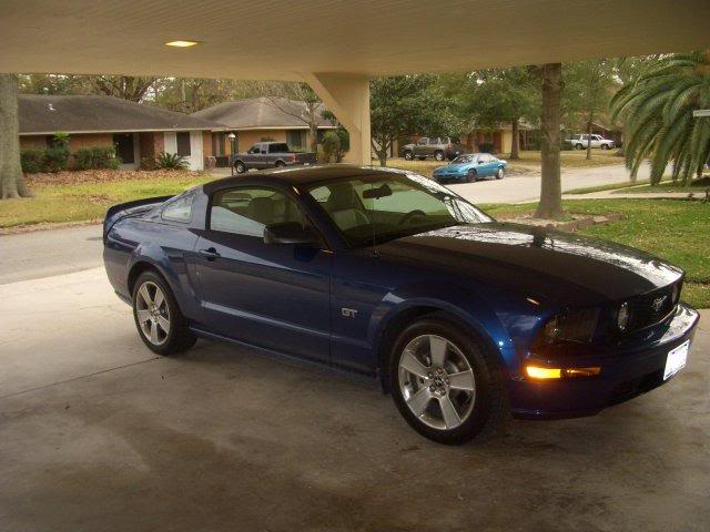

time for a drop and tint! whats everyone going with on the 05-06 GT?
